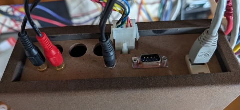

Just wire up the tuner connector (needs additional pins for the docking connector) and stick it out the back or mount it in the back panel. That's how I do it.

So I have to cut open my beautiful MLDock? Not sure what/where the 'extra wires' of which you speak

No need to cut anything open. There are four screws on the underside of the dock for opening things up. The tuner module uses extra contacts on the docking connector for its wiring -- those contacts are not populated, so you would have to order a few (DigiKey), and crimp the tuner connector wires to those, and insert them into the correct slots of the docking connector (from the rear).
Just dangle the connector assembly out through one of the cooling holes on the rear of the dock.
I think the FAQ must have info on the docking connector pin-out somewhere. The instructions for the tuner may also have that info(?).

Thanks Mark. I am not the sharpest knife in the drawer and I need pictures. What plug to where, and what contacts do I need to order? I could not figure out the contacts...Sorry.
